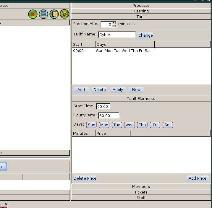

Dear Friends, I am currently installing Mkahawa in one of my cybers. I have installed the clients and the server and they can communicate properly. Now, I am stuck on the tariff part... I want to charge the kawaida 50cts per minute with a Ksh. 10 minimum... I have tried all manner of combinations on the tariffs setup tab, but I simply cannot figure out how to setup the abovementioned rates. The billing is going haywire and sometimes it charges more and sometimes less... I have attached a screenshot herewith of the place I should enter the figures. If there is a Skunk/Skunkette/skunkling herein who has setup Mkahawa, please please please guide me on how to setup the tariff...please...tafadhali... Timo.
That part also ate my head (ilinikula kichwa) for some time. I dont quite remember what I did but try this, set 9.50 for 19 mins or set 10.00 for 20 mins one of them should work. Regards, Mugo On Wed, Jan 4, 2012 at 3:00 PM, Timothy Mutugi <timothymutugi@gmail.com>wrote:

Thanks Mugo, I have just implemented your suggestion and the hourly rate of 30.00 & 10.00 for 20 mins is working perfectly...ahsante sana! Lakini...Now how do I get it to start with a default Ksh. 10 as a minimum fee for users who stay for less than 20 minutes? Timo. On 1/4/12, m mugo <mugo2of3@gmail.com> wrote:

Set "Franction After" to 20 minutues On Wed, Jan 4, 2012 at 4:35 PM, Timothy Mutugi <timothymutugi@gmail.com> wrote:

Thanks so much guys, all is well and the timer is now 100% accurate. Timo. On 1/4/12, maina <dmaishe@gmail.com> wrote:
